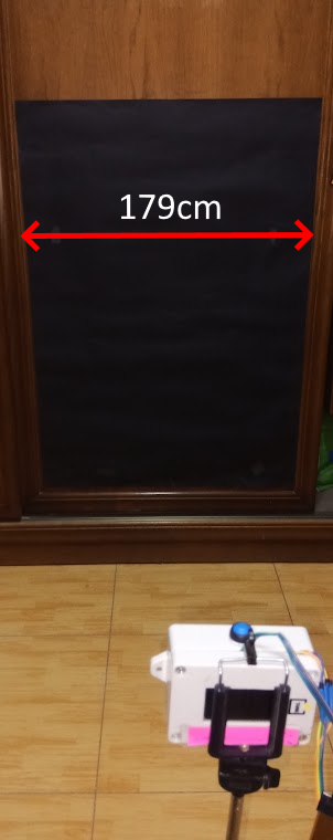

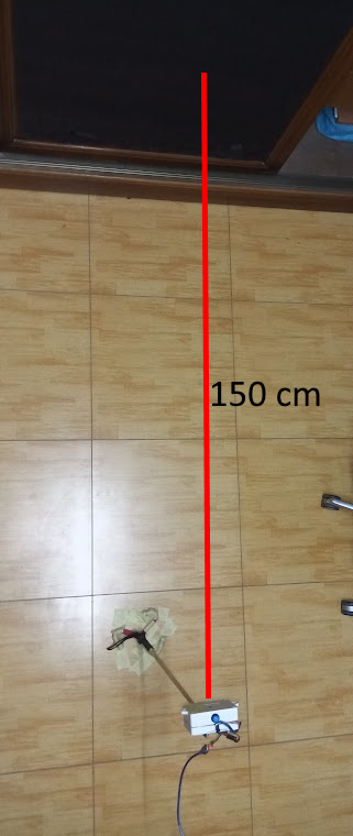

I've tweaked and implemeted the black page (dull to a percent) better than the previous setup (more flat across the page).
So uncalibrated measurements were only down by 1.4% in average, further xTalk calibration has went down to around 121.
What was interesting to note is that by narrowing FOV, the range is overly measured:
The average measurements at 8*8 ROI centered (Long mode, 100ms TB) is 1609.
The average measurements at 4*4 ROI centered (Long mode, 100ms TB) is 1978.
The calibration environment is set as shown in images:
Any hints?

I really need to ensure a point: I don't really perform any kind of calibration set after changing FoV, Should I perform it? (offset calibration, calibration of xTalk with uncalibrated offset returned xTalk of zero (0), as it over-ranges)
I'd like to mention that without performing the calibration, I get 'over-range' not vise-versa (160cm 8*8, 198cm 4*4), seems strange really, but this is the observation.
I appreciate your suggestion, it'll be in our option list for sure, but genuinely we are heading towards providing working prototypes to clients as quick as possible (We'd be testing on a test tank before that for sure).
Back to the issue: The sensor at daytime just reads the liquid level sufficiently, but starting at sunset and until the next day, the sensor sees the dear ghosts continuously xD.
Removing the coverglass will kill the chip (It goes decapped and defect) (because of water vapour, to our observations).

Hi John, sorry again for incomplete statement.
The over-ranging with narrow FoV is observed at lab setting shared earlier. so there's no real thing it can see further 150 cm, I've made sure that the sensor faces the center of the black paper.
I'll try a cardboard instead and I will share updates soon.
