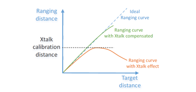

The other is a crosstalk issue where some target is at about the right distance when the target is close, but as the target gets farther and farther away, the distance gets shorter and shorter.

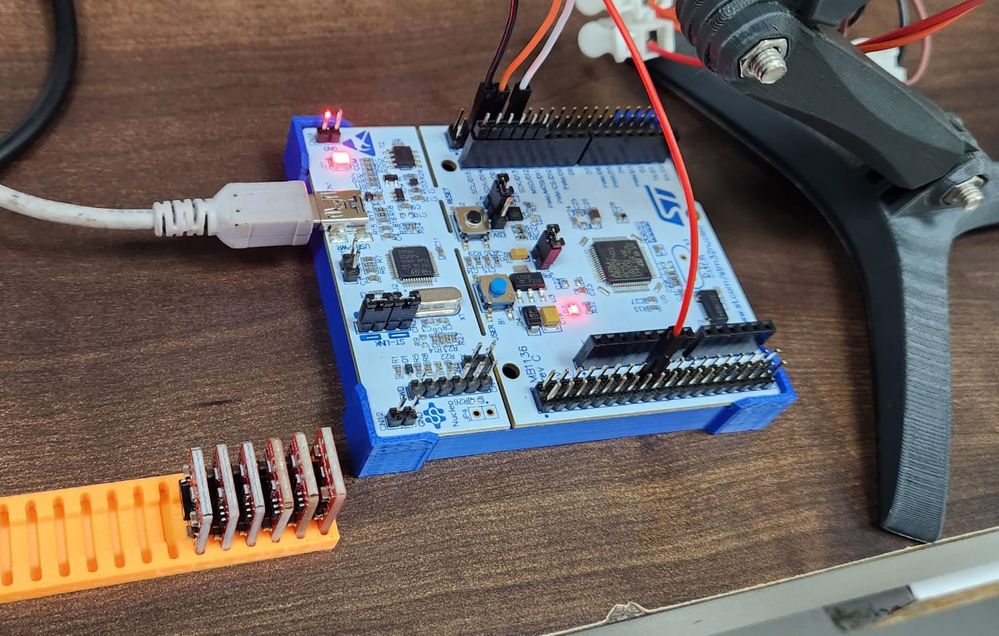

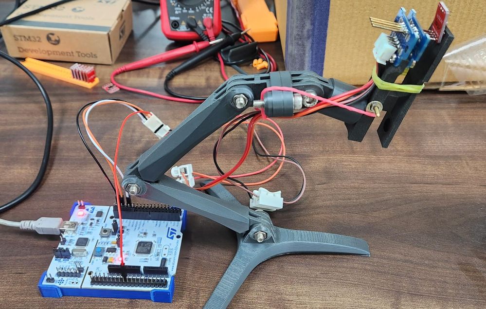

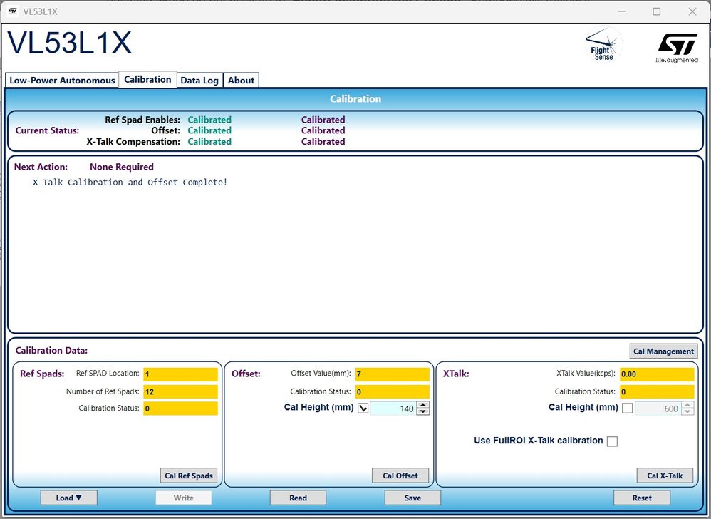

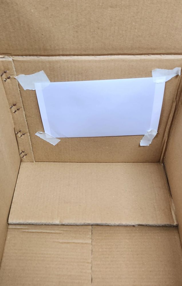

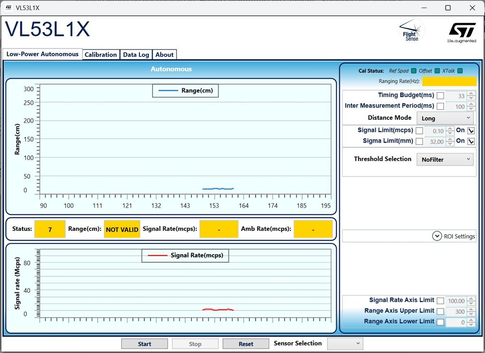

I went through various of your replies to people having issues with this sensor and decided to try recalibration with ST's software. I hooked it up to a Nucleo board and recalibrated in a dark box with the sensor at 140mm from a 17% gray sheet as recommended in the manual.
Please advise on the correct calibration procedure in case I am doing something incorrectly. I have attached photos of the setup and software screenshot.
What I have noticed is that that the sensor can detect a white sheet at 50cm in Short mode, 30 cm in Medium Mode and 18cm in Long mode. I find this very strange, perhaps this could shed some light on what's going on?

2025-05-23 10:50 AM
Use white paper at 140 cm to do the offset correction.
Use the dark gray or black to do the crosstalk correction. Distance is highly dependent on your coverglass. Do some experiments - range until you find that place where you are under-ranging by 10 or 20%. Then do the crosstalk from that distance.
In your case without a coverglass you should not have anywhere you are under-ranging. If you do, your sensor has an issue.
If you cannot range beyond 40cm, you either still have the Kapton tape on, or there is debris on the filter.
Double check for the tape.
Do the calibration, then clean your filter. use a gentle chemical. Just water, maybe a little alcohol in it. Maybe some ammonia, but go easy. The do the calibration again.
Does anything change?
- john

2025-05-27 8:15 AM
We can assume something is wrong. So, let's do an experiment.
Take a good sensor and range on something.
get the signal strength and number of SPADs.
Then take a 'bad' sensor and do the same thing in EXACTLY the same.
If you conclude you are getting 20M photons and using 62 SPADS on a good sensor and are only getting 10M photons using 162 spads then we know that there is not as much light returning from the target.
Two ways to make this happen. A blockage on the transmit side, or a blockage on the Receive side. In a naked sensor this is hard to do. With a coverglass or with an obstructed housing it's easy.
Is your sensor installed - or out in the open?

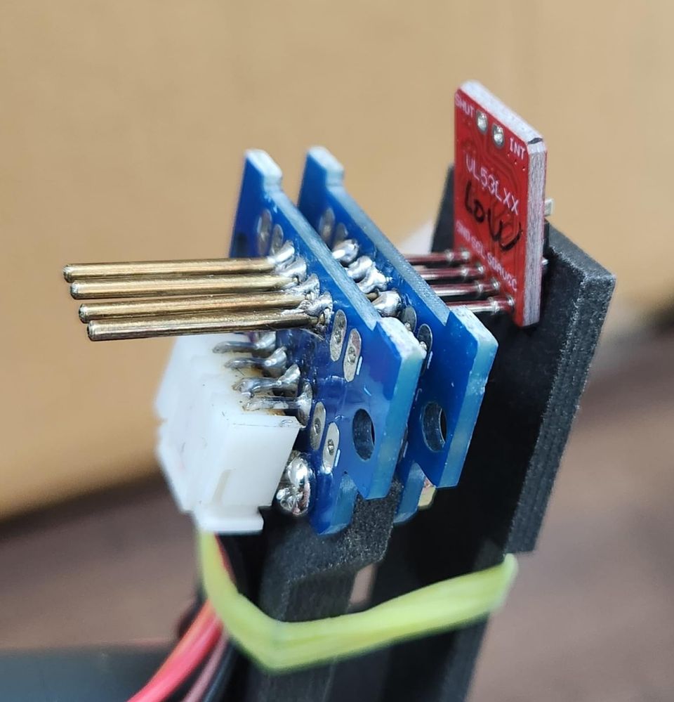

in your picture, could it be that the black object be covering part of the Field of view?
Re-adjust the sensor so that black bit is well away from the sensor. The light goes out in a code of 27 degrees, but there is roll-off at the edges. Perhaps that holder is reflecting and making a mess.
