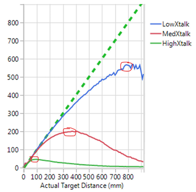

About xtalk calibration, can you share your ranging data in dark condition? normally we suggest do xtalk at reorted distance start to drop, refer below picture.

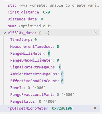

  follow is offset calibration value:14cm

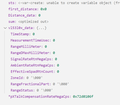

follow is talkcross calibration 60cm  not under sun

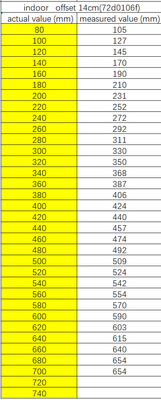

  I positioned the glass cover in front of the sensor and performed offset calibration at 14cm. The actual and measured distances are as follows. Where should I perform the CROSSTALK calibration?

From the data seems your calibration is not succeeded, or you forgot set the offset value after rebooting, normally after doing offset, if you do range measurement, the reported distance will be around 140mm, but your measurement data is 170mm.
Anyway, from your test result, I suggest you do xtalk between 650~700mm.
