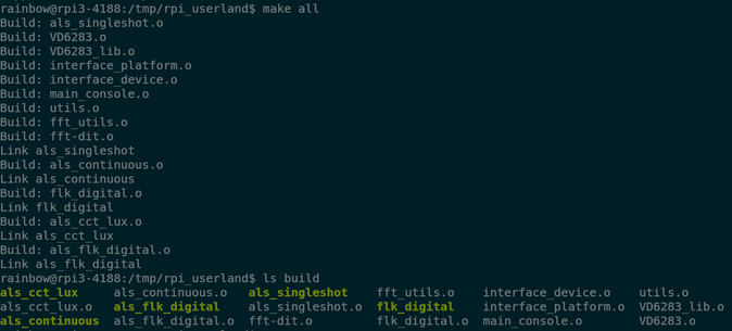

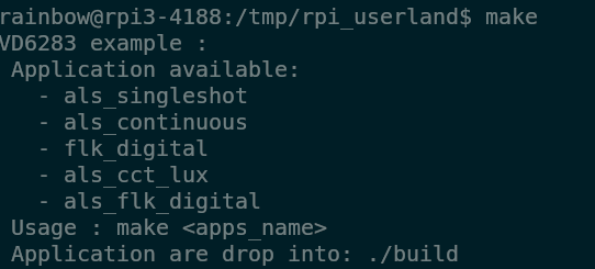

When you run make without specifying a target, a brief help message is displayed. For example:
When you run make all, all the examples provided in the package are compiled. The resulting binaries are placed in the build directory. For example:
The application are in green.
