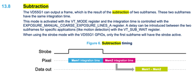

Hi there, I'm trying to figure out how to configure VD55G1 monochrome sensor to differential mode (e.g. disruptive mode, event mode) as branded in user manual. However, after going through https://github.com/STMicroelectronics/stm32-mw-camera, I have no clue. Could you help me with this? Thank you.

This is the frame subtraction function, which is also explained in Appendices B and C.
The difference between them is that Appendix B requires the host to process the subtraction, while Appendix C performs it on the sensor side. Both appendices also include sample code for your reference.
I have attached the sample code to enable the subtraction for you. For more details, please check the sample code in the appendices.

I guess I made it ambiguous. This is what I'm looking for.
