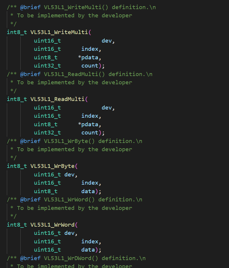

Thank you for the guidance. I am looking at STSW-IMG009. I understand I have to include both the platform and core files in my application. Is that correct?
What I am not able to understand is what to write in the _platform.c functions. It says the developer needs to write these functions. I am not able to find information about what these functions are exactly supposed to do. Here is the .h file which just says "To be implemented by the developer"
Also, where can I find info about what 'dev', 'index', '*pdata', 'count' are?
