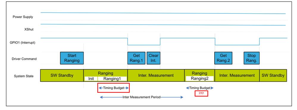

I am trying to get consecutive measurements from the VL53L1X sensor but the timing budget is only kept on the first measurement with the below code

2023-01-19 1:59 AM
When the Start command is given the VCSEL flashes once and the interrupt line goes high.
Then when I clear the interrupt the interrupt line goes low and never high again.
If I use the Start-Stop technique for a single measurement and clear the interrupt, the timing budget is being kept and the interrupt line goes low upon clearing and then high when I Start ranging again. If I don't clear it, the timing budget is not kept the second measurement on.
