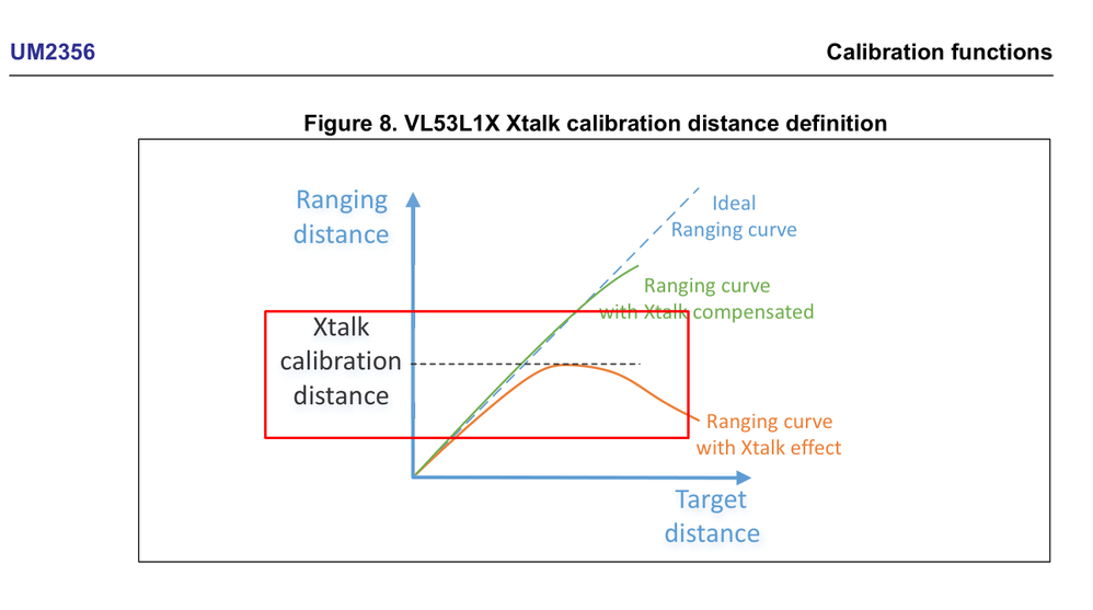

Document UM2356 shows:
which shows the calibration point to be when the measured distance is the same (and lower) for an increasing target distance.

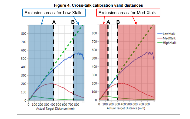

Document UM2039 shows:
where the point is a bit after the curve.

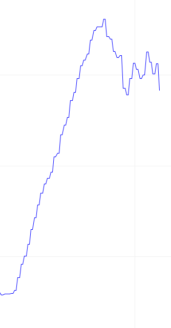

In my case I get this which is pretty instant after a certain point:
Should I use the max point (orange arrow) or the point before that (red)? The max point is 2353mm (actual) and I am measuring 2150mm (sensor) (8.5% deviation).

When you calibrate you are trying to find an object that technically gives you the wrong answer.
After calibration it should give you the right answer.
But when you found a target good for calibration, you found a target that is basically hard to see.
Calibration will not make you see things at a farther distance. I will just give you better answers at the distances you can see.

2023-01-18 4:20 AM
I went ahead and spray painted some cardboard. I am indeed seeing the deviation at a much shorter distance of 778mm (actual) and 609mm measured.
At that point I calibrated XTALK which gave a result of 4890.
I then set that value with VL53L1X_SetXtalk.
However the range of distance I can now measure is still the same on the black cardboard, meaning I can only measure 0-770mm with this waveform peaking at around 770mm:

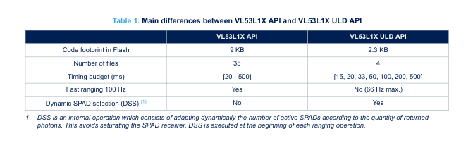

Document UM2510 shows that the ULD API has Dynamic SPAD selection:
Does that mean that I don't have to do any SPAD management?
thanks
2023-01-20 7:05 AM
that means from one range to the next, we analyze the number of photons received and adjust the number of spads we use for the next range. Using all the spad with a near or bright target just wastes power. (After every 'hit' the spad must be reset.)
If life were perfect we would get 20Msamples per second. More than that we turn off spads.
In subsequent releases we have better adjustment of the timeing budget in the ULD.
We kind of gave up on the whole concept of refSpad calibration. Turns out the value in the chip is good enough, and re-calibration was not leading to better results. So it was left out of the newer drivers.
