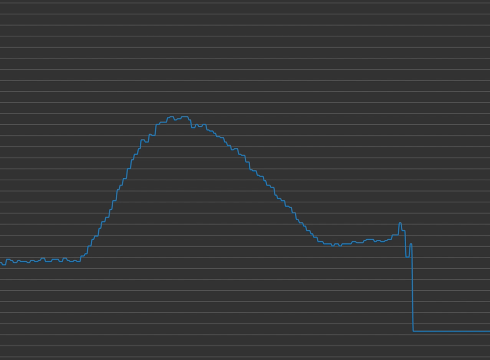

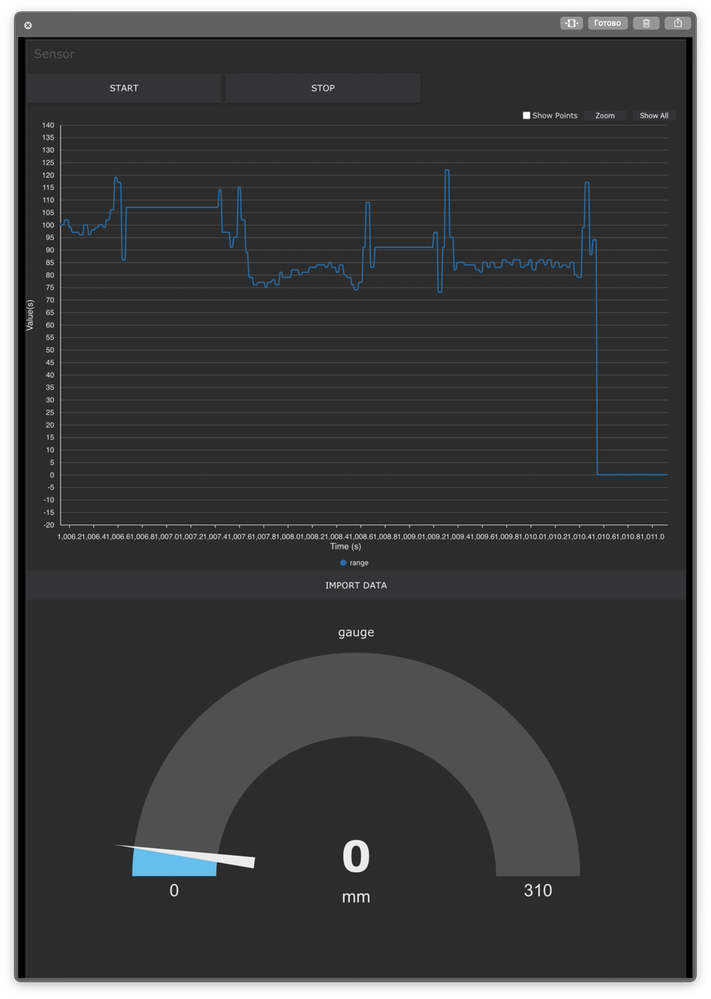

I get the correct data (distance to the obstacle), with a normal change in the position of the obstacle (zoom in / out), the data changes correctly and corresponds to the real distance.
If the obstacle is sharply removed from the "field of view" of the sensor, I get 0 (or very small, 0-25mm, values), although it is logical to get infinity. I can’t understand, is this the usual behavior of the sensor, then I will make a code check or is it some kind of problem with my sensor?

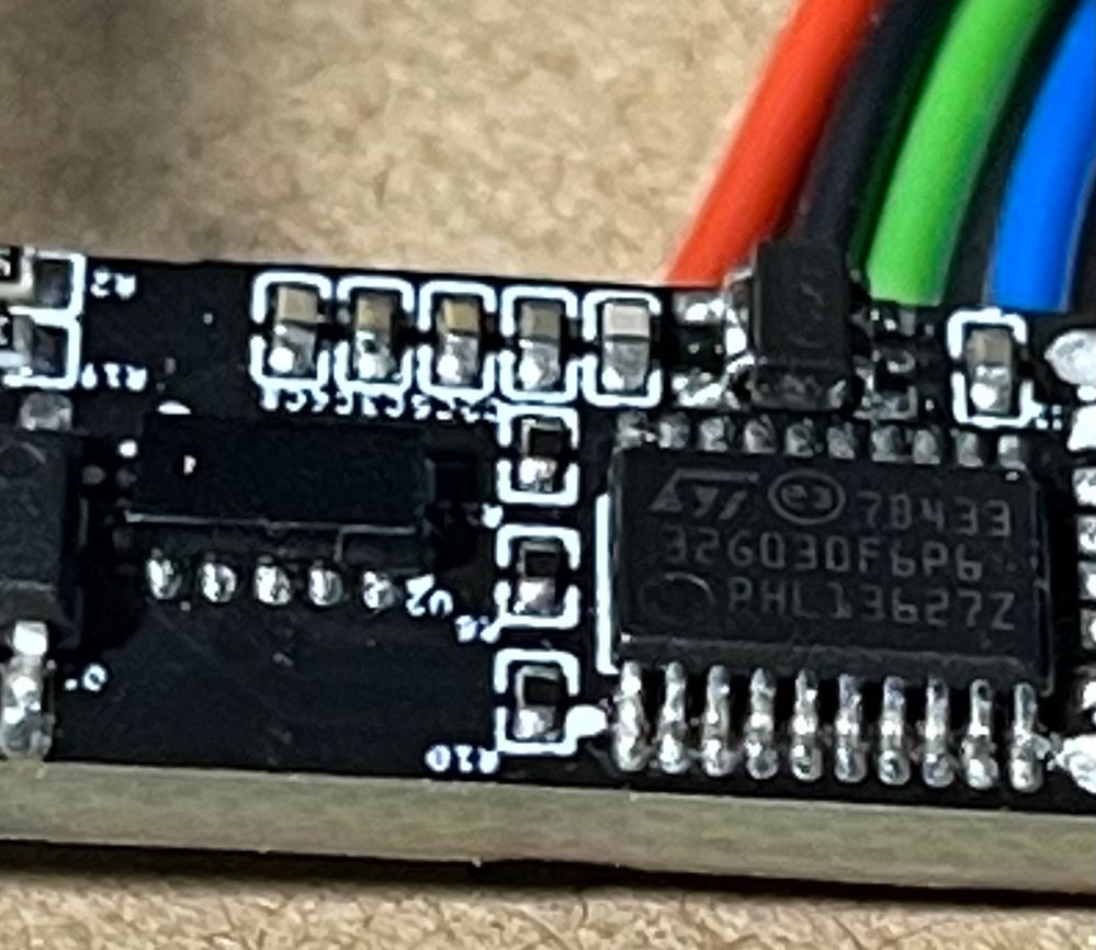

Before that, I used sensors soldered on the board and did not encounter such behavior. The described situation occurs on the board of my PCB ordered in jlcpcb, but once again I will pay attention, most of the data is correct! This baffles me.
