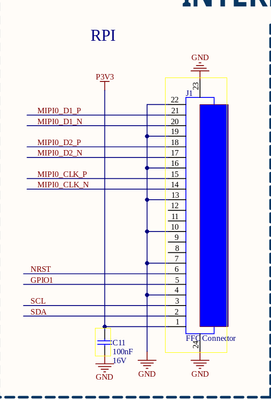

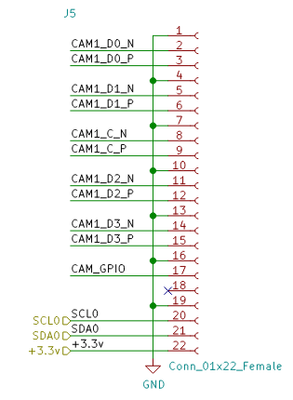

I see the Reset pin and the Cam GPIO pins are swapped, along with the data lines. Raspberry PI Pinout:
and the STEVAL-CAM-M0I pinout:
Thanks

The two DTS folders in the provided driver, which are labeled "rpi1_to_4" and "rpi5" are not categorized by *pi type/generation*, as they are named. But categorized by *board type*. The generic Pi 1-4 boards share a 15 pin FFC connector with a specific pinout. The Pi 3/4 CM-IO breakout boards, along with the generic Pi 5 board share the 22 pin FFC with a different pinout. These are the two DTS categories.
If using the CM4 on the CM4 IO board (and also the CM3 and CM3 IO board), it shares pin compatibility with the Pi 5. So you must use the Pi 5 DTS, not the Pi 4. Which was my issue.
