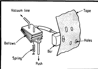

I didn't suggest a nozzle. I said a bar with a hole in it - something like this:
(that shows vacuum; I suggested pressure)
As you can see from the article - it's actually a very old concept!
