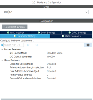

I am not using SPI so as per your response on another query this must be a misconfigured I2C . I have already gone through most of documentations UM3109 , UM3108 , AN5945. Can you tell me what should be the configuration of I2C ?
This is what I have done, What could be wrong here.

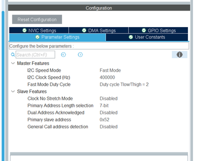

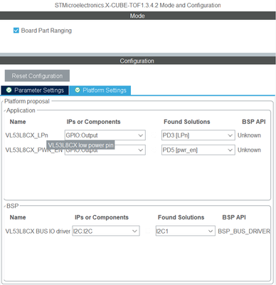

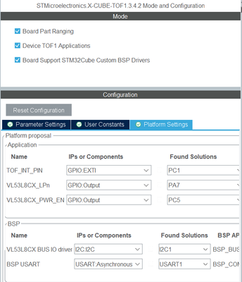

I also tried another and TOF configuration for it is here
Please let me know what needs to be changed

When you generate the code, do you get:
* @brief I2C1 Initialization Function
* @PAram None
* @retval None
static void MX_I2C1_Init(void)
hi2c1.Instance = I2C1;
hi2c1.Init.ClockSpeed = 1000000;
hi2c1.Init.DutyCycle = I2C_DUTYCYCLE_2;
hi2c1.Init.OwnAddress1 = 0;
hi2c1.Init.AddressingMode = I2C_ADDRESSINGMODE_7BIT;
hi2c1.Init.DualAddressMode = I2C_DUALADDRESS_DISABLE;
hi2c1.Init.OwnAddress2 = 0;
hi2c1.Init.GeneralCallMode = I2C_GENERALCALL_DISABLE;
hi2c1.Init.NoStretchMode = I2C_NOSTRETCH_DISABLE;
if (HAL_I2C_Init(&hi2c1) != HAL_OK)
Error_Handler();
This is what works for me.
I don't have a discovery board, but I know that processor has more than one I2C. You need a schematic to verify that you have chosen the correct I2C pins. Make sure it's I2C1.
(And the ClockSpeed will work at 1M but sometimes you have to change it after you generate the code.
If you have a scope, See if you are getting any wiggles at all on the I2C.
And until it gets working - keep you i2C wires short.
