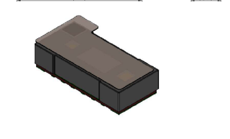

Thank you for your reply.
I mean the little foile on top of the VL53L5CX like in the picture below.
kind regards
This liner is put to protect the sensor from soldering.
To use the sensor, you have to remove the liner. If you use the sensor with it, it explains your  faulty measurements.
Our community relies on fruitful exchanges and good quality content. You can thank and reward helpful and positive contributions by marking them as 'Accept as Solution'. When marking a solution, make sure it answers your original question or issue that you raised.
ST Employees that act as moderators have the right to accept the solution, judging by their expertise. This helps other community members identify useful discussions and refrain from raising the same question. If you notice any false behavior or abuse of the action, do not hesitate to 'Report Inappropriate Content'
Thank you for your reply,
so in this case i can use it safe without this protect foile?
Kind regards
Maik H
Yes that's safe. No worry.
Regards
Anne
