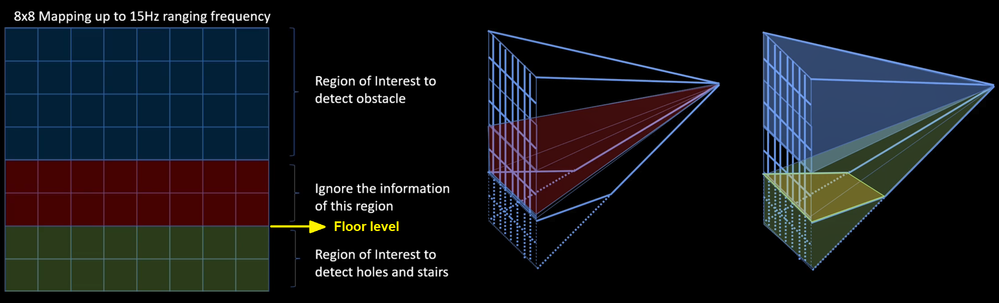

Among the other features that impressed me is the sharpner. Thanks to this feature I could sharpen the division of the zones. Having said that, my idea was to divide the matrix of interest into 2 zones:
- Region to detect holes or stairs below the floor level
- Region to detect other obstacles above the floor level
I had actually also thought of a third zone to be interposed between the two zones just mentioned

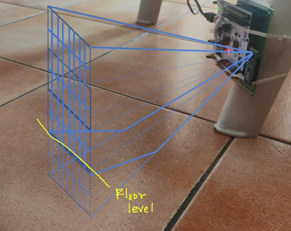

The scenario I had in mind was something like this:

The sensor would be fine, just as you described it. This is exactly how we suggest our customers use the device.
There is only one flaw that I can think of... If the floor is a mirror-like surface (specular) the photons might hit the floor and bounce away without ever returning. If the sensor does not see a return signal, it cannot get a range.
I'm going to guess there are not that many highly polished mirror-finish floors, but that is the only scenario where I see a flaw.
I tried a marble floor tile, and that has enough micro variations that you get a return signal, but that does not guarantee such a tile does not exist.
Good luck,

2023-12-11 6:17 AM
It's math. If one knows you are at a particular angle to the floor at at a known height, you should be able to work out the distances one would expect assuming a flat floor. (or you can just run the sensor and see what you get.) Add a tollerance to those numbers and run your robot.
If you get anyting unexpected, it's a object. Probably something to aviod.
Keep in mind that the distance and the signal strength are both useful. An object will probably reflect a lot more photons than a floor at those angles.
I'd get a good sample of floors and give it a try. Wood, tile and carpet are the most likely, but there are zillions of different floors. And unfortunately, that is the challange.
