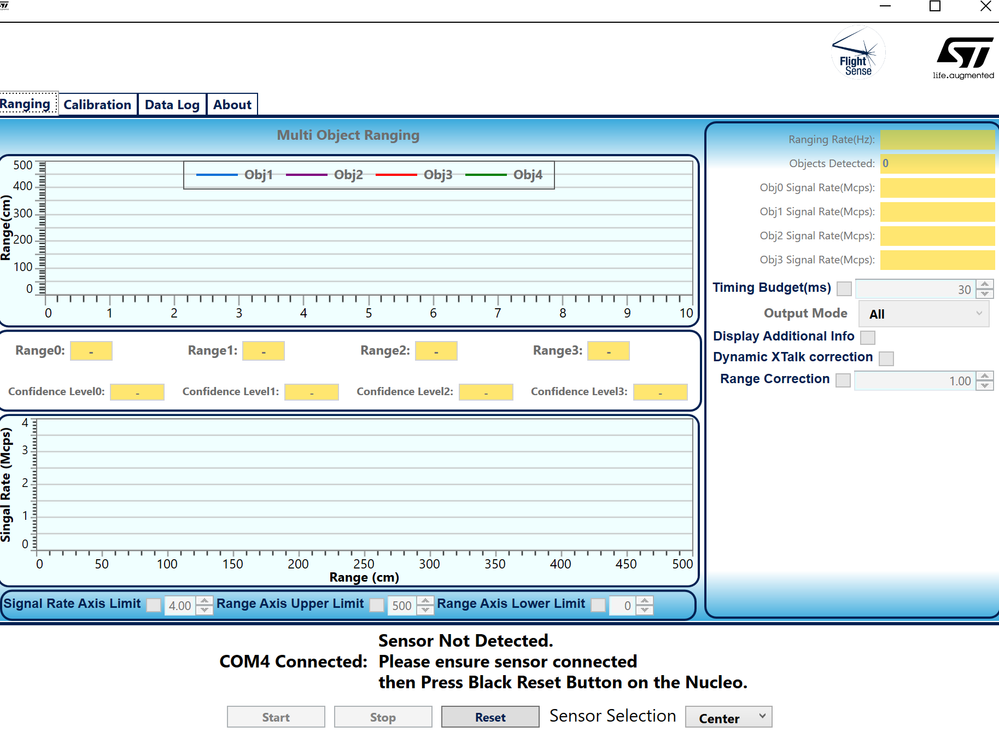

I have the X-NUCLEO53L3A2 development kit. I'm trying to get the VL53L3CX_Gui running. It connects to the development kit via USB but will not detect any sensors. I have updated the firmware, installed the STSW-LINK007 and STSW-LINK007 drivers as instructed in the user guide. I cannot get the GUI to detect any sensors. It just continuously says "Sensor Not Detected. COM4 Connected: Please ensure sensor is connected then press black button on Nucleo". No amount of resetting, plugging, replugging, relaunching the application, reflashing the device seem to clear this up. I can get LD1 to turn solid green but cannot do anything with the kit. There are sensors left/center/and right connected to the board.

Hi John. I see the drive and it is mapped as D:
Is there something special I need to do to download the API. When I go to the about section in the GUI I just see "API Version: TBC". The only contents of D: shown are a DETAILS file and MBED file.
I did see the LED flashing when I downloaded the code, then it went solid green. The sensors appear to be oriented correctly. Even when I remove the left/right sensors I get the same error.
