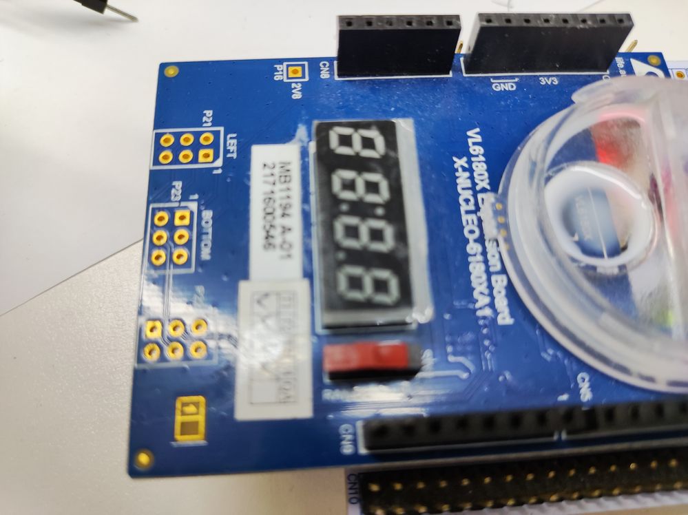

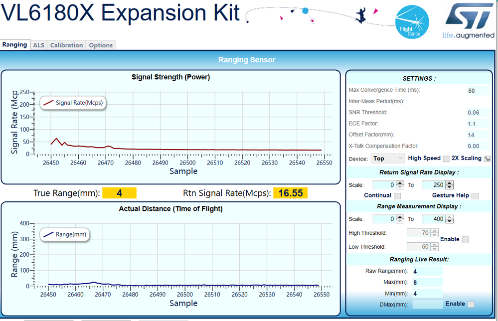

0693W00000JPpBLQA1.png0693W00000JPp7EQAT.jpgAs in the picture, there is a chance that the cover will be stained with milk. At this time, the measured value is wrong. Is there a way to reduce this effect? I've tried adding a baffle between the tx and rx, but it's basically useless for this case.
