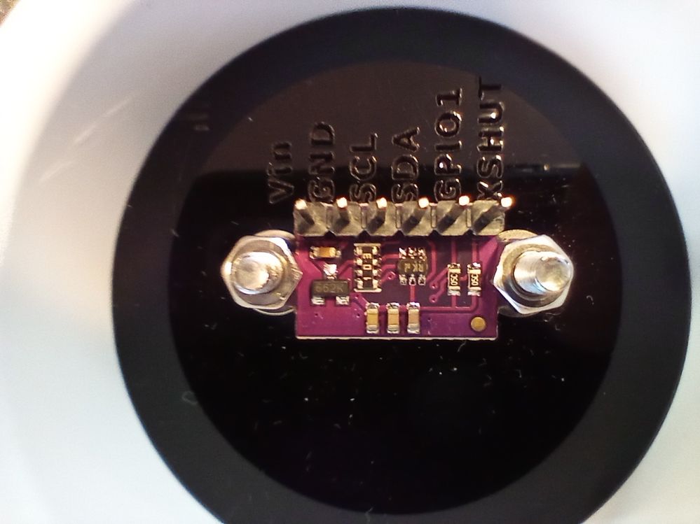

The L0X is installed in a ~half full steel 275V oil tank with zero ambient light and it has a cover with cross talk barrier.
I know that the 4CD would probably be better, and I am experimenting with at present, but the availability of breakout configurations is much more limited so that will be a mechanical problem.

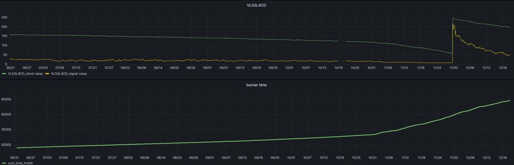

Just a 6 month follow up. Bottom graph is oil burner run time hours in 100ths. Total 157 hours over the period. The top graph is the VL53LCD distance measurement converted to gal remaining(green) and the "signal" measurement(yellow). There was a 177 gal fill on 11/29. Total consumed over the period 138 gal. Works out to 0.88 GPH. It's a 0.85 GPH (marked) nozzle.
At fill time I ordered 185gal based on the data and the tank took 177. There's some subjectivity in guessing when he's going to show up on my end and on the driver's end when the whistle stops and he shuts off the pump. It's all close enough for me. The signal level minima was 7-8 when the level was as low (measured distance was at its maximum) as I ever want it to be. So all good. I did have one mid-october system hang. I don't remember what it was but it was not sensor related and easy to fix with a reboot of something. I've got these VL53L4CDs on three tanks now with AliExpress covers (literally $1.50@) running on ESP8266s and they all work great.

I would really like to use the 4CD because of the FOV angle because the tank has a curved bottom. The narrower angle will get me closer to the bottom before picking up returns from the sides. I can't figure out a good and simple way to mount your hole-less breakout board with the 4CD. Right now I am using the Chinese L0X boards that have the 2mm holes on either end and room for the Hornix cover screw-mounted to a 3mm thick black acrylic sheet, laser cut for the 2mm holes and the cover oval. That mount plate is then glued into a PVC adapter with pipe thread for the tank fitting. Unfortunately the guys in China haven't picked up on the 4CD part yet, as far as I can tell.

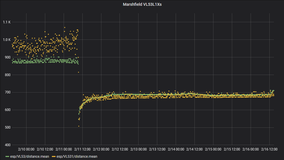

Really? Coulda fooled me. Let me see if I can get to my data at another location where I have two tanks/two VL53L0s running on identical code with only different SignalRateLimit settings.The yellow sensor has been running with a SignalRateLimit of 100kcps and the green 25kcps.
The discontinuity is a result of having the oil company come deliver some oil last week. They were supposed to deliver 200gal (100@tank). I believe (from my remote location) that this indicated the driver was probably stoned and misread the order to deliver 100 into each tank delivering, instead, 100gal total. I was expecting around a 400mm delta. Being remote, I don't know for sure if the offset (uncalibrated as yet) was really bad and a function of distance, or what.
The only way to know for sure is to either drive down there and find the delivery slip or wait for the charge to come through on the cc, and at $3.50/gal I don't want to rush them on the cc. My bet though is they delivered 100 instead of 200.
If I understand what you are doing in the code on the device (i.e. "When you get a bad range we put 8192-range_status into the distance result"), if this condition occurs whenever the SignalRate < SignalRateLimit, then it is going to happen at higher frequency when signalRateLimit is set higher than it will when it's set lower. Also, it will happen more frequently measuring longer distances, than it will measuring shorter distances (by inverse square).
I believe I see this effect in the data as well. I think I am going to have to take a drive.....
Anything more you can tell me to illuminate what's behind the curtain will no doubt improve my shadow boxing score.

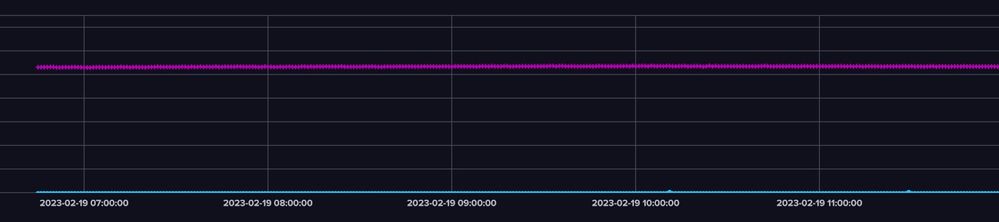

I now filter the data and exclude any points out of valid physical range and the problem is gone. I also keep track of the number of bad points on each read cycle as a measure of if and by how much the signal returns are deteriorating. The magenta (below) is the oil volume in the tank and the two little blips on the blue line are one bad data point each, diring those two read cycles(out of about 300). Now they are not summed in nor is their index value added to the divisor. No impact now on the published result, but this IS what WAS generating the offset-to-a-higher-value data lines.
You were 100% on the money. Thank you.
