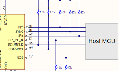

Thanks for your response. But the VL53L8CX sensor doesn't have a sync IN pin; there are GPIO1 and GPIO2 pins. Thus, instead of the SYNC pin, I made GPIO 1 an input. Then I tried to debug the sensor for external triggering in autonomous mode, but it didn't work.

See page 15 for your external sync question. The SYNC pin is GPIO2 (B1) and you need to use a 47K pullup resister to IOVDD. Set your trigger pin on your controller to LOW (pulling B1 to GND) until you are ready to trigger. The trigger will occur on the rising edge > 0.7v when you set the trigger pin HIGH.
