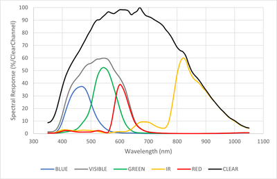

Thank you for your reply. We are currently considering using the VL53L8CX in combination with the VD6283TX for a specific application, instead of the VL53L4CD. However, we’re concerned about potential interference between the two sensors when placed in close proximity. Could you or someone else clarify whether any disturbance might occur in this configuration?
Thanks
2025-06-12 9:30 AM
the VL53L8CX operates at 940nm and that is in the low infrared area. It's clearly in the IR band of the VD6283TX.
As it doesn't interfere with the RGB or Visible, you can still use those.
But the ALS chip is fast. You could run the L8 in Autonomous mode and leave a small gap between measurements. In those gaps you could run the ALS and do what you need to do.
Or - as the VL53L8 has a sync pin - you could stall the L8, take your ALS measurement and then trigger the L8.
- john
