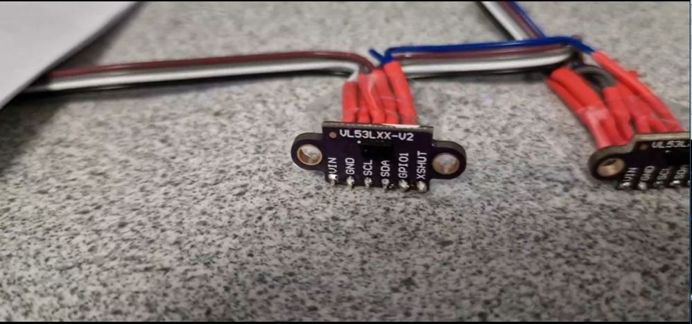

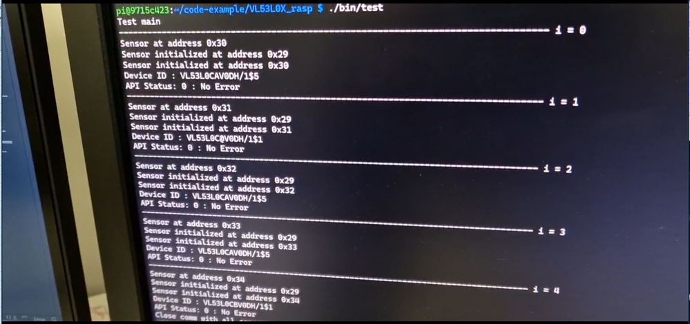

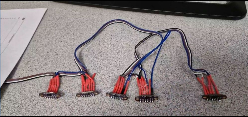

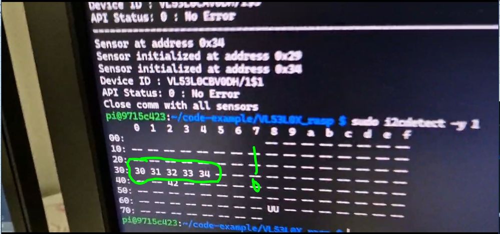

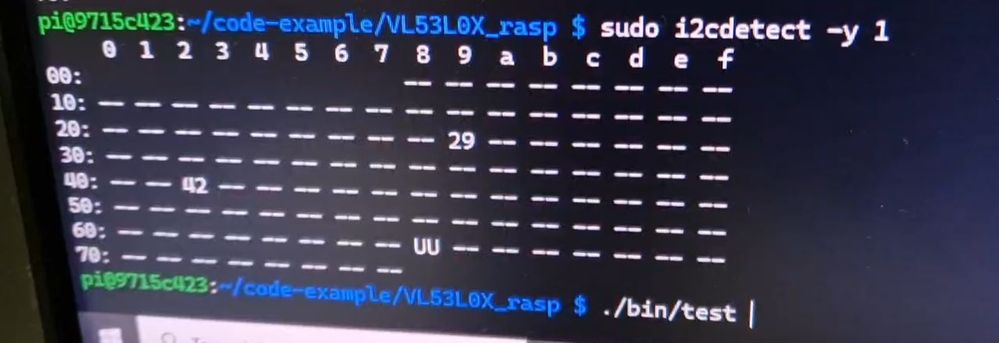

Hi John !
You wrote "Long story short - unfortunately you cannot cheat. You need one line for the Xshut on every sensor." :thinking_face:
Now loock at this :face_with_tears_of_joy: :
Just 4 I2C wires + only a fifth wire in cascade between GPIO pin and XSHUT pin of sensors and wihtout multiplexer.
It seems that you underestimate your products
