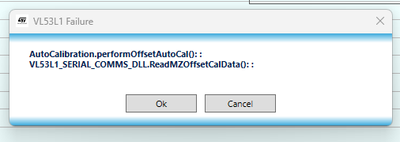

However, when using MultiZone 10x10 Ranging, the GUI constantly crashes. During calibration, the following message appears:
Is this a known issue? What could be the problem?
What do I have to do to be able to use the devkit?

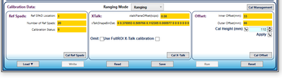

I used a 10x10 as in:
But notice that "Use FullROI X-talk calibration" - that's interesting. That message does NOT pop up unless you reduce the RoI, so someone thought about it.
Is that what you used?
I'm thinking for the larger RoI's the difference in calibration between partial and full is so subtle it wouldn't matter.

I noticed that you performed the calibration for the ranging mode. For me, the calibration also worked well in that mode. However, I’m referring to the MultiZone Scanning feature.
