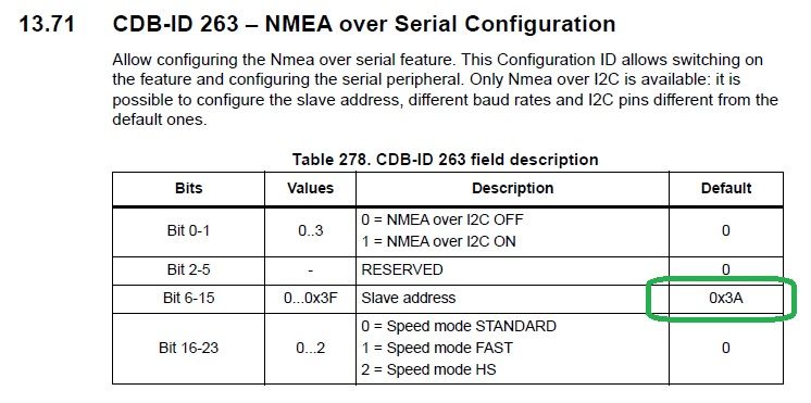

HAL_I2C_Master_Transmit(&hi2c1, 0x3A << 1, (uint8_t *)gpgll_msg, strlen(gpgll_msg), 2000)
>> what is 0x3A << 1 here ?
Is it the Teseo 7 Bit address?

I2C here using 7-bit, STM32 expects these in the high order bits, so shifted there.​
