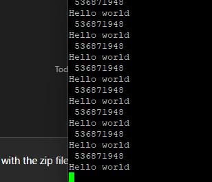

swayamsidhmohanty
Associate II
Hi
I have conducted the tests either way.
There is some progress I can say. Initially I was trying to power up the GNSS module using the USB Type A to USB MIcro ( Laptop to the module). Now I tried with powering it up with the 3.3V from the MCU itself and while i do that I do get some interrupts. Initially I did doubt the reliability of jumper wires but now it is also cleared since I ensured continuity among wires. Since I dont have a scope or logic analyzer( i have ordered it - it might take some time), I cannot monitor the signals.
About the Interrupt that I received, the code parses the first character and then checks for the symbol '$". It didnt work.
So I increased the no. of characters to 10 then i received this output
Hello world is just to check the UART between the MCU and my computer. Please dont mind it.
The no that i get is 536871948. I find it strange that ASCII code for $ is 36 and G is 71. And in UART serial monitor I am getting NMEA sentences starting with '$G....' and the output we got somehow has these codes. 5-36-8-71-.... There is a character in between.
Is this meaningful data. If yes should we parse it this way.
What are your suggestions to read data using DMA over this character by character approach?
536871948 = 0x2000040C  the address of rxChar array in memory.
Your handler is now expecting 10 characters, you make no attempt to process them in that form
I'd recommend mastering C coding before trying DMA. Perhaps work with colleagues or supervisors to guide you.
