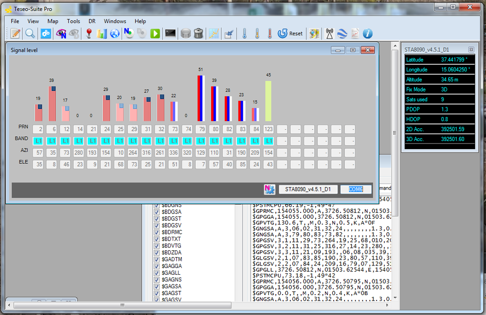

I have a CLOE board, I detect an average of 7 satellites with a SNR between 25 and 45 during the cold start but I can't have a fix. The CLOE board is running with a TESEO III chip.
Does anyone know the conditions to have a fix ?
Moreover, I have an EVB-LIV3F, also based on a TESEO III chip and I can have a fix in 3 min 30 s with the cold start.

I just took a FIX from COLD in 34 seconds! (NOT minutes) on a EVB-LIV3F... and my antenna is not well placed.
Is the antenna well placed out-side?

Hi
I have similar numbers (approximately 25 to 45) but I have a FIX from COLD in 34 seconds.
You should have the same with your EVB-LIV3F + Antenna provided in the kit
