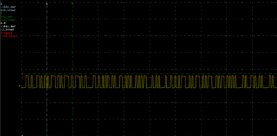

There is nothing on the any of the teo buses. jumper setup as described by you. J13 ON.
I was wrong UART6 works, I see the signal.

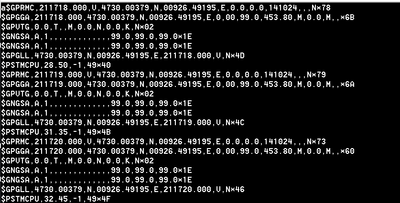

There is a continous transmission from Teseo to the controller.
this is what being sent
And this is what comes trough COM3

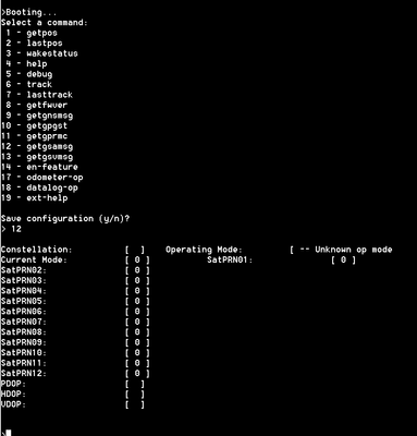

If you are running Virtual COM Port example, you should see NMEA data output on the serial terminal.
If you are running GetPos, then you would see the command terminal with the options you had shown in a previous post.

To understand where you are, it looks like you are getting output using the Virtual_COM_PORT but not data is seen on GetPost. Is that correct?
If you are getting output on Virtual COM Port your project setting (GPIO, UART, Interrupt and Callback setting) should be the same for GetPos as well.
If you set a breakpoint on the following, is it never getting hit?
msg =  (GNSS1A1_GNSS_Msg_t *)TESEO_LIV3F_GetMessage(&teseo_liv3f_obj);
 Can you try option 8 in GetPos, reading firmware version? If it is communication, you should read firmware version from Teseo module.

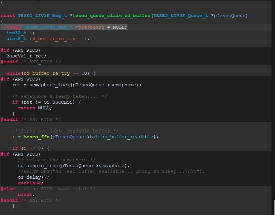

function hits, however:
after
while(rd_buffer_re_try == 1U)
teseo_ffs returns 0.
static inline int32_t teseo_ffs(uint32_t _w)
  int32_t r = 1;
  uint32_t w = _w;
  if (w == 0U)
    return 0;
The function exits with break;
and the function:
const GNSS1A1_GNSS_Msg_t* GNSS1A1_GNSS_GetMessage(uint32_t Instance) returns msg = NULL.
