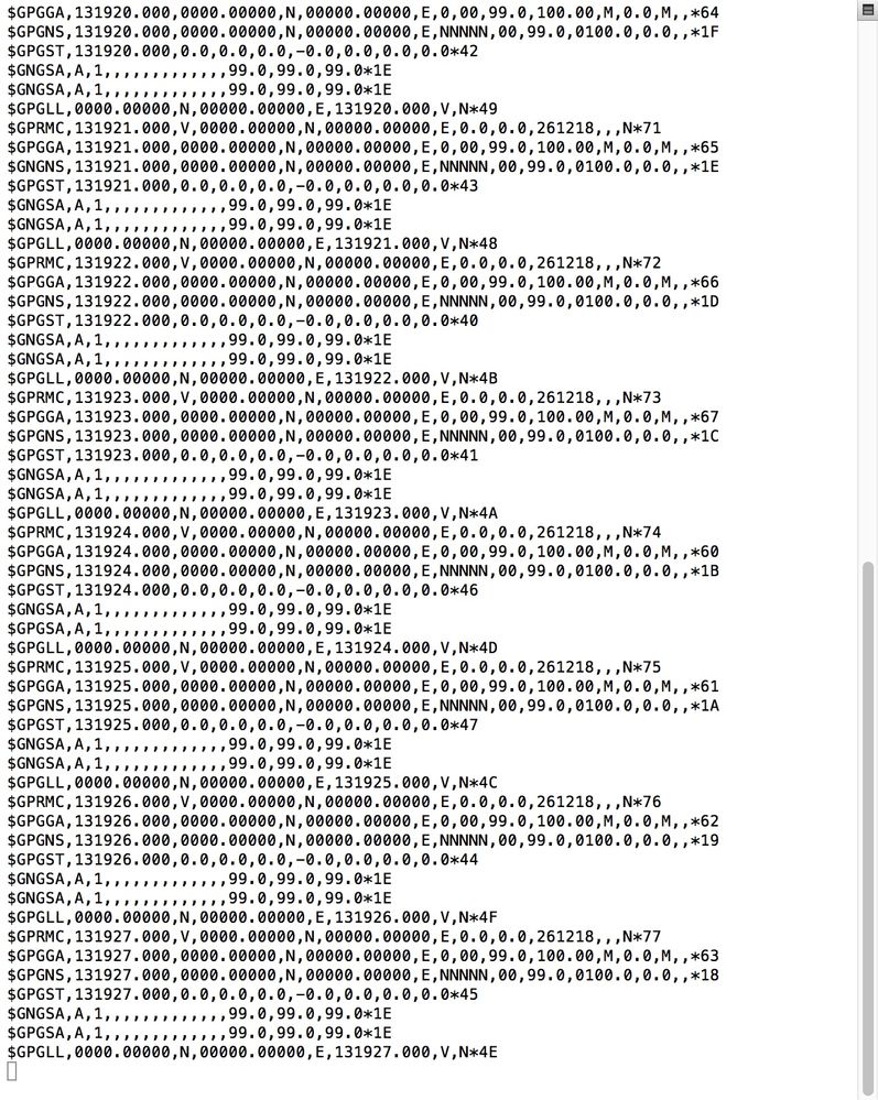

Hi, after playing it for a while, I am able to communicate with the X-NULCEO-GNSS1A1 via USART
But the altitude and longitude are not correct, it is not changing. Not knowing what to do, I decided to perform a cold start by sending the command "$PSTMCOLD, 6", and after doing so, the NMEA messages become all zero
I've tried many commands. Such as reset engine, perform hot start, etc. but no luck.
Any advice or idea will be appreciated, thank you.
