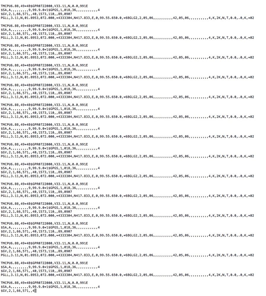

Hi, as the title said, I am having the hard time communicating with X-NUCLEO-GNSS1A1
The GNSS module is communicate via USART (can't communicate via I2C, but this is the other problem)
the code is written as follow:

}For some reason, I cannot use HAL/LL library, and I'm using opencm3, but I think this is not the reason, also, there is some freeRTOS stuff inside, but it also should not be the reason, the result is shown in the picture
As one can see, the command of the message doesn't show properly, e.g. "$SA" instead of $GPGSA "", having a larger buffer does not solve the problem. What should I do to fix the problem?
I have read the src code in CubeMS, and it is really hard to understand it, also there is a little example online, so I am literally in the dark, the software manual is not that clear IMO, even though I know those command, but I simply can't produce expected result.
This is only one of the problems, any advice or idea will be appreciated, thank you

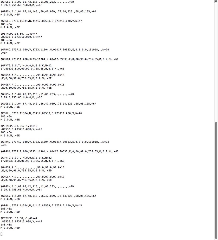

Hi, this is my result, is this the thing that I should expect? There seems to have some weird new line.
I'm using USART IRQ now, the result look a lot more better than previous one, but I'm not sure if this is correct or not.

2018-12-25 11:32 AM
OK, after re-read the software manual, I found that most of the new line is part of the format, so those are normal result.
However, I can't find $PPGLL $PSGLL on the software manual, and also $PSTMCPU has strange format which is different from the one I saw one the software manual.

Hi
Sorry to say but during run-time your are loosing chars in your code.
> $PPGLL $PSGLL
What are they?
Every NMEA message which begins with '$P' is a proprietary message.
The ST proprietary messages begin with '$PSTM'
Sorry but $PPGLL and $PSGLL are not ST message and you'l never see them from Teseo-LIV3F.
As said you are losing chars.

Hi, in the beginning it looks like I'm losing chars, however, those chars appear because I did not clean the array after receiving the line, the problem was resolved if I clear the array right after line transmission done.
Anyway, thanks for your advice!
