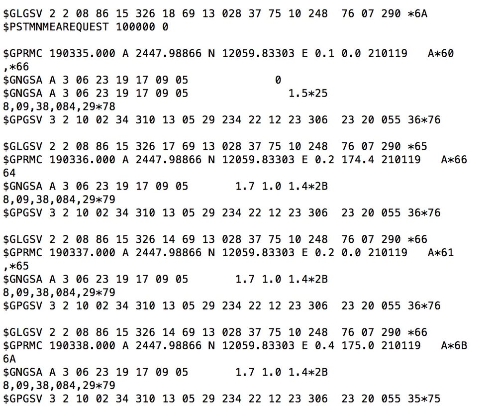

2. After reconfigure the message list by the command "$PSTMCFGMSGL,0,1,0,0" and "$PSTMSAVEPAR", nothing
changed, I'm expecting this since the Baudrate doesn't change immediately, as well. When I request the
message via command $PSTMNMEAREQUEST,100000,0 (GPGLL), I didn't get what I expected, instead, I get this
Which is totally different from the application note, and I don't know what to do, the manual is rather confusing to me.
Any advice would be great, since I'm literally having hard time getting this module to work. Thank you.

2019-01-25 12:17 AM
Hi, the problem still persists
There are few questions I want to ask:
Thankyou
2019-01-25 1:16 AM
> we should append checksum and cr, lf at the end of the string
Yes. correct.
> which has the wrong checksum, what is happening?
Really strange. I tryed all the commads and they work on my side.
Could you check your code?
Do you want share?
Just a note (sorry I forgot to say) but the whole C-Driver for Teseo-LIV3F is already online @
in the package you will find binary for STM32 and all the C-Code. May be it could help your development.
Regards
Franceco
2019-01-25 8:24 AM
Hi, I've checked my code, and there is some subtle mistake, resulting in the wrong checksum. Even though it works fine in online compiler.
Thank you really much, really appreciate it.
