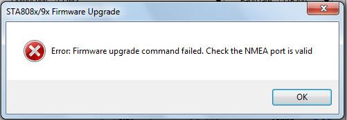

The standalone version of errors does not give out at start!
Hi
>But, there is no connection with Teseo-LIV3F.
Do you have any COM-port on PC connected with Teseo-LIV3F ?
