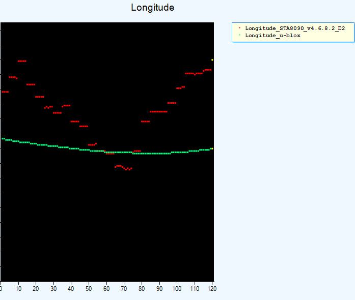

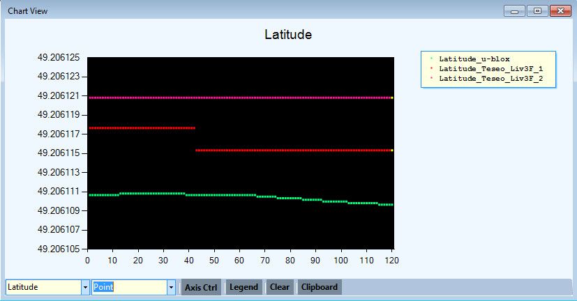

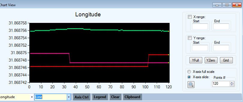

Hi! Why are the coordinates (latitude and longitude) of the Teseo-LIV3F changing abruptly and not smoothly like the u-blox M8 and NV08? Smooth change of coordinates is very important to me, since the direction angle is calculated in our program precisely

Just a question looking the image...
Are you comparing devices with the same frequency FIX rate?
Are both the device running at 1 Hz FIX?
Thanks
Regards
Francesco
Hi
I compare devices with the same FIX frequency.
Both devices operate at 4 Hz FIX. Devices work on GPS, Galileo, Beidou.
UART 9600, NMEA RMC, and GGA output rates.
