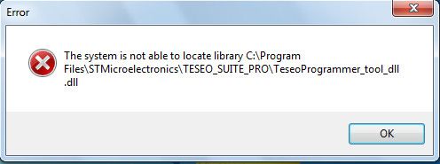

Hi
So that's the point, Teseo-Suite throws an error when you press the STA808x / 9x FW Upgrade button in the Tools menu?

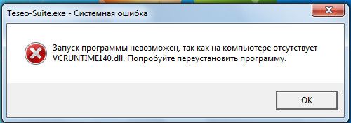

Hi
thanks for the help
version of Teseo-Suite - 5.2.3.4
install Teseo-Suite as Administrator
