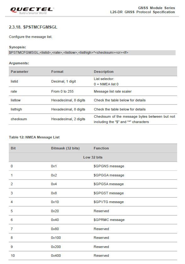

Hi, what is the function of the rate, list low, and list high parameters? I am trying to understand how to configure the message list, thanks

Rate is there to down-scale the message-list again the Fix-rate
But just one more question L26-DR GNSS is a Quectel module, which embeds a TeseoIII, therefore you should ask support to Quectel on the specific module and on what they did on the module.

sorry, the module uses Teseo and ST commands so I thought I could post this question here, thanks
