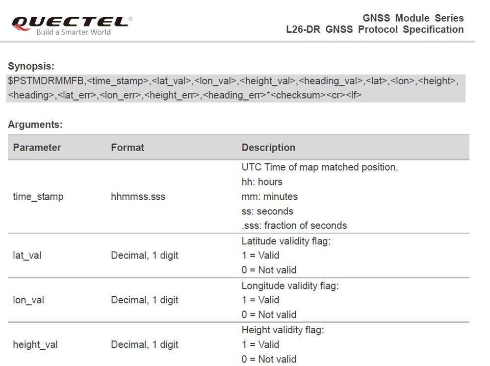

Hi, what is the function of this command?, the L26-DR GNSS Protocol Specification says “Input map match data�? but I don’t know when could be useful

To establish the speed/location into the DR/IMU at some known starting point. Could be stationary if you want to clear sensor drift.
For example outside an ambulance barn, exiting a parking garage, or a pit box with known location.
Francesco Virlinzi
MMFB stands for Map Matching FeedBack.
It can be used when the platform take data from a Map provider (i.e.: TomTom Map or other....) this map-information can be provided to the TeseoIII to improve the accuracy.

And when should I send a validity flag as valid or not valid?
