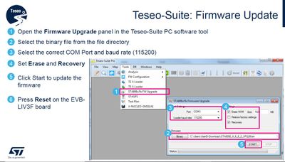

Also, please ensure, that GNSS2A1 is running the latest firmware. You can download latest firmware here, https://www.st.com/en/embedded-software/teseo-vic3dsw.html
You can use Teseo Suite to upgrade firmware.
Go to Tools > Teseo FW Upgrade.
Attached is a reference on the procedure. This picture was from an older version of Teseo Suite but the fields are the same.
