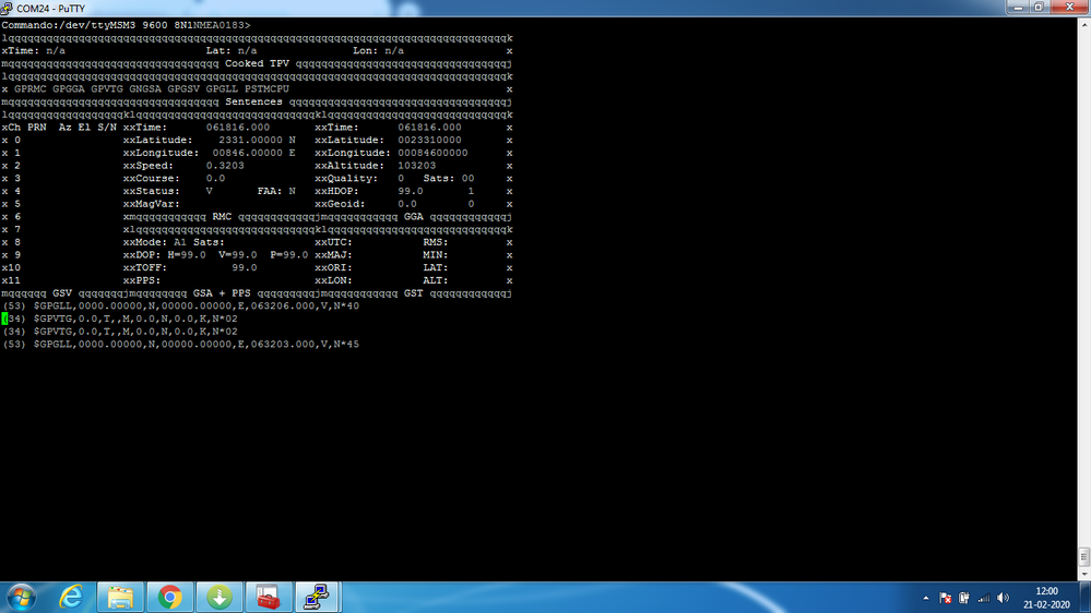

2020-02-20 10:34 PM
Hi @Francesco Virlinzi
I am testing with gpsmon application, getting wrong latitude and longitude values(tried almost for 20mins). Is any tuning/calibration required for this GPS module? If tuning required please let us know the procedure to do the same.
Thanks,
Yash
2020-02-21 12:08 AM
Hi
Looking the $GPGLL message... in this message the position is reported... all the fields are zeroed.
The module is not evaluating any Position.
More probably you have some problem with antenna.
I assume you are testing outdoor. Is it?
Thanks
Ciao
Francesco
