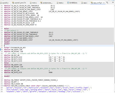

STM32_Programmer_CLI.exe -c port=SWD mode=HOTPLUG -el "$env:DKEL" -hardRst -w network_data.hexInside CubeIDE, when I run the app it is extremely slow and I never see frames from the camera.
When I do the same with st_yolo_x_nano_480_1.0_0.25_3_int8 and set:
#define POSTPROCESS_TYPE POSTPROCESS_OD_ST_YOLOX_UF
everything works perfectly well.
Has anyone managed to run Yolov8_n on the STM32N6570-DK with people/vehicle detection?
Any hints on postprocess config, arena/memory pool size, or model export settings would be greatly appreciated.

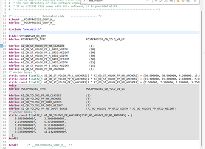

In your case, because you have 80 class, you need to change:
I used the ST Model Zoo services for that:
STMicroelectronics/stm32ai-modelzoo-services: AI Model Zoo services for STM32 devices
For the yaml, I used this one as a starting point:
As explained here:
ultralytics/examples/YOLOv8-STEdgeAI at main · stm32-hotspot/ultralytics
I took the generated app_config.h in \stm32ai-modelzoo-services\application_code\object_detection\STM32N6\Application\STM32N6570-DK\Inc.
