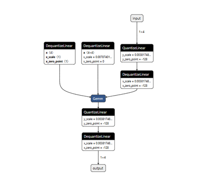

However, when I tested a very simple model (shown above), quantized through the ST Developer Cloud, I saw this:
Total number of epochs: 5 of which 3 implemented in software
epoch ID HW/SW/EC Operation (SW only)
epoch 2 -SW- ( DequantizeLinear )
epoch 3 -SW- ( Conv )
epoch 4 -SW- ( QuantizeLinear )
Here, even Conv was executed in software, despite the model being quantized.
Why does Conv2D run in software in the second case, but in hardware in the ResNet-8 case?
Does the hardware accelerator require a certain layer structure, padding style, kernel size, or input alignment to be offloaded properly?
Is there a way to force or hint that a layer should run in hardware if it technically can?
What are the conditions under which DequantizeLinear and QuantizeLinear run in hardware?
Thanks a lot

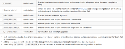

The Aton compiler (which manages the epochs) is looking at your memories and NPU configuration and tries to get the best (fastest) combination it finds.
You cannot manually force any layer into HW or SW. but you can try to change some options to change the outcome of the aton compiler.
For example, you can change the optimization mode and try the 3 available (by default it is in auto and will select the best)
(https://stedgeai-dc.st.com/assets/embedded-docs/stneuralart_neural_art_compiler.html)
You can find general tips here:
For your second question in particular, you can look at the layer supported as you will find more information about what is done: https://stedgeai-dc.st.com/assets/embedded-docs/stneuralart_operator_support.html#ref_size
