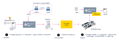

I think we can check if the issue comes from ST Edge AI Core or Model Zoo by manually using ST Edge AI Core. To do so, please try the following:
/opt/ST/STEdgeAI/2.0/Utilities/linux/stedgea
./stedgeai generate --model YOUR_MODEL --target stm32n6 --st-neural-art
(I don't use linux, so the first part of the command is maybe wrong, but the options are good)
Let it run and if it run as it should, you should have a message saying it is complete.
If it works, we at least know that ST Edge AI core is working.

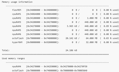

I have one more question. As my understanding, currently I am running with internal flash (user internal memory). Is that right? and How much memory I can use with this model? I want to know this value to estimate whether my AI model can be run with this settings.
Moreover, I know that STM32N6570-DK supports SD card. It means that we can deploy all C source code + AI model to SD and run inference for LARGER models. Is that right? If it is correct, could you please provide guide link to do this (about how to set up board to run with SD card, how to build and flash, it is better if it comes with AI model).
2025-03-26 2:04 AM
Hello @Anhem,
You can find the memory available and used when doing a stedgeai generate. For example:
https://stedgeai-dc.st.com/assets/embedded-docs/stneuralart_getting_started.html
When you use external memory (other than cpu and npu ram in the image above), the performance in terms of inference time reduce drastically as it needs to gather the data from external memory before using it.
So yes, you can run larger model and use SD card, but it is not advised. If your use case do not need a fast inference time for any reason, it can be useful though.
I am not an embedded engineer, so I don't really know how to use a SD card. You can ask the MCU forum board about that.

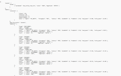

Regarding AI, you will for sure need to edit the memory-pool file:
Memory-pool descriptor: file: $STEDGEAI_CORE_DIR/Utilities/windows/targets/stm32/resources/mpools/stm32n6.mpool.
When you use the st edge ai core, it looks at your memory pool file that indicate what kinds of memories are available, their start adress, size etc.
If you look at the default one, you will see that you have a description of the memories available that correspond to the first image I sent.
Because our real use case tends to be focusing on fast inference time, we don't currently have any example using SD Card.
Have a good day,
Julian
