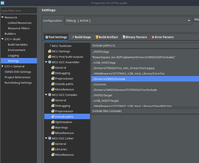

look, are this "missing" files in path ? maybe, you have to add path... if not there.

no, you misunderstood.
if download was ok, all needed files should be there.
just maybe , a path to use/include is wrong or missing; that i wanna show.
so first take an example project, to see, all is working.
and for missing .h -> search file on your disk, then control, that this is in path-settings (or add, if not there)
