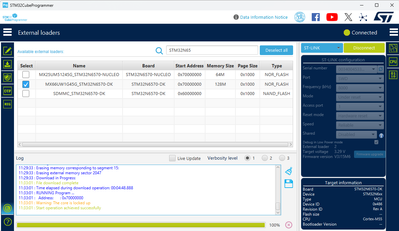

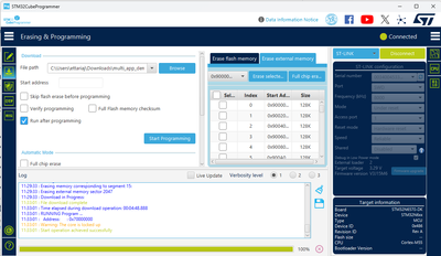

2025-03-07 2:46 AM
Hello @Einstein_rookie_version ,
What demo are you trying to use exactly?
Here is an example of what you should generally be done:
Have a good day,
Julian
