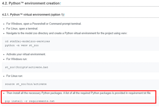

I followed below tutorial and tried to install STM32 model zoo.
At "step 4.2.1", I encountered following problem.
ERROR: Could not install packages due to an OSError: Failed to parse: http://username:password@proxy.url.com:port
WARNING: There was an error checking the latest version of pip.
I am not sure my username and password.(ST website login e-mail and password?)
Could you guide me how to fix this problem?

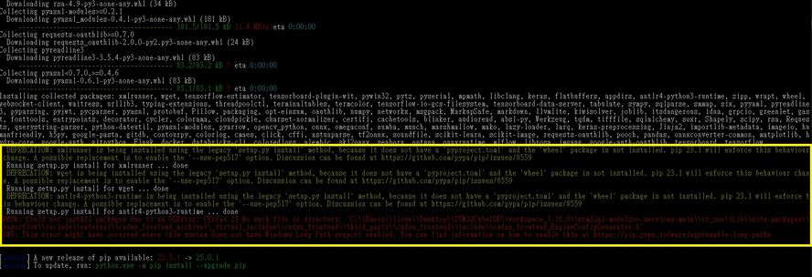

2025-03-06 1:55 AM - edited 2025-03-06 1:57 AM
Hi @hamitiya ,
I deleted environment variables and ran "pip install -r requirements.txt" command.
It seems work, but I have no idea whether the following info and error can be ignored or not.
If it can't be ignored, how to solve the error ?
DEPRECATION: xmlrunner is being installed using the legacy 'setup.py install' method, because it does not have a 'pyproject.toml' and the 'wheel' package is not installed. pip 23.1 will enforce this behaviour change. A possible replacement is to enable the '--use-pep517' option. Discussion can be found at https://github.com/pypa/pip/issues/8559
Running setup.py install for xmlrunner ... done
DEPRECATION: wget is being installed using the legacy 'setup.py install' method, because it does not have a 'pyproject.toml' and the 'wheel' package is not installed. pip 23.1 will enforce this behaviour change. A possible replacement is to enable the '--use-pep517' option. Discussion can be found at https://github.com/pypa/pip/issues/8559
Running setup.py install for wget ... done
DEPRECATION: antlr4-python3-runtime is being installed using the legacy 'setup.py install' method, because it does not have a 'pyproject.toml' and the 'wheel' package is not installed. pip 23.1 will enforce this behaviour change. A possible replacement is to enable the '--use-pep517' option. Discussion can be found at https://github.com/pypa/pip/issues/8559
Running setup.py install for antlr4-python3-runtime ... done
ERROR: Could not install packages due to an OSError: [Errno 2] No such file or directory: 'C:\\Users\\ilove\\Desktop\\STM32CubeIDE\\workspace_1.16.0\\stm32ai-modelzoo-services-main\\st_zoo\\Lib\\site-packages\\tensorflow\\include\\external\\cudnn_frontend_archive\\_virtual_includes\\cudnn_frontend\\third_party\\cudnn_frontend\\include\\cudnn_frontend_EngineConfigGenerator.h'
HINT: This error might have occurred since this system does not have Windows Long Path support enabled. You can find information on how to enable this at https://pip.pypa.io/warnings/enable-long-paths

2025-03-06 2:29 AM
About the first deprecations warnings, I would say you can continue.
However, for Windows Long Path, it is mandatory (for ST Edge AI Core) to correct this error.
You can fix it by executing this command in a PowerShell in Administrator Mode:
New-ItemProperty -Path "HKLM:\SYSTEM\CurrentControlSet\Control\FileSystem" `
-Name "LongPathsEnabled" -Value 1 -PropertyType DWORD -Force(from: Maximum Path Length Limitation - Win32 apps | Microsoft Learn)
