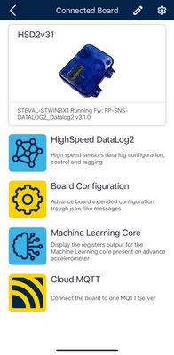

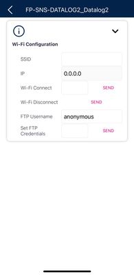

Currently this is my application as viewed in ST BLE Sensor app (iOS)

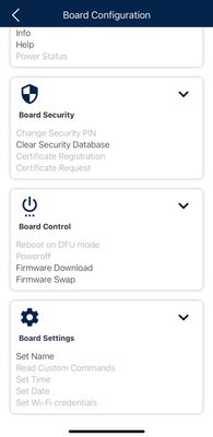

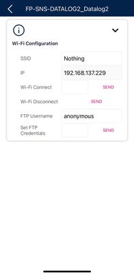

I have first tried with the iOS app, it doesn't let me to use the Wifi connect button or disconnect.

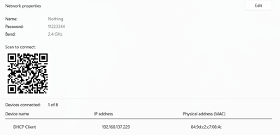

and this screenshot from the computer that a device is connected :
MAC address prefix 84:9D:C2 is registered to Shanghai MXCHIP Information Technology Co., Ltd., ( Google )

So far, I could not get the wifi working as expected,
Issue#1 : Can't configure WIFI in IOS app. Hence, can not verify FTP properly.

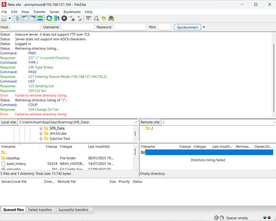

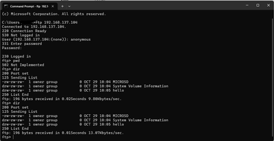

Issue#4: FTP retrieval in this situation, i have only until WIFI connect command and it is connected. Following the ST WIFI FTP connect guide for datalog2, my device is not responsive. Here is the FileZilla screenshot
or inside command prompt
C:\Users\xx> ftp 192.168.137.104
Connected to 192.168.137.104.
220 Connection Ready
530 Not logged in
User (192.168.137.104:(none)): anonymous
331 Enter password
Password:
230 Logged in
ftp> dir
200 Port set
550 Bad Directory
ftp>

A small update to the FTP retrieval.

The iOS application has just been fixed internally. The patched application will be pushed on the app store in a few days.
