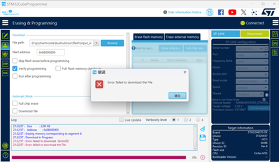

Hello, I am currently trying to write my input_data_int8.bin file to flash, but I keep getting an error that says 'Error: failed to download the file'. How can I fix this? Thanks!

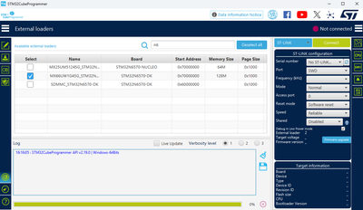

Hello @llcc,
did you select the external loader for the DK board?
(Click on the bottom left EL icon)
Have a good day,
Julian
2025-07-08 7:24 AM
Yes, I have. I've now identified the issue. It was caused by an incorrect Start Address setting. Changing it to 0x70000000 resolved the problem.
