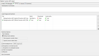

Debug configuration (FSBL project)
I start debugging from the FSBL project.
In Debug Configuration → Startup → Load Image and Symbols, I configured:
  • second_Appli.elf
    • Download = OFF (already flashed manually)
    • Load symbols = ON
So FSBL is loaded/debugged, while App and model are already present in flash.

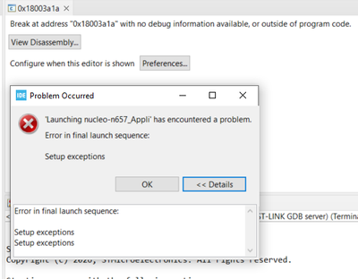

This is what im getting with the latest configuration that you proposed
