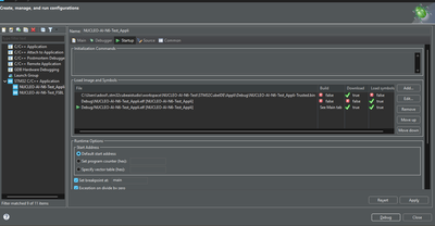

I am running into a persistent debugging issue with a generated STM32Cube AI Studio application on the NUCLEO-N657 board. The debugger seems to drop the connection when transitioning from the "FSBL" to the main application "Appli" , and subsequently locks up.

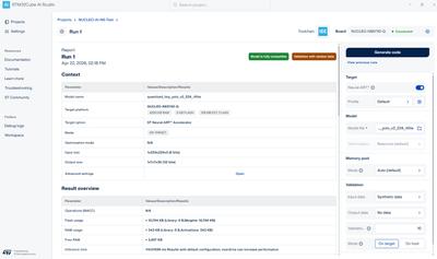

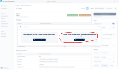

Note: The code is generated properly from STM32Cube AI Studio, and the model .hex file is downloaded successfully to the NUCLEO board:

  1. During the first time debugging the program, it starts correctly.
  2. I run the "FSBL" application, and it executes properly.
  3. As soon as the execution jumps from "FSBL" to "Appli", the IDE throws a "Target is not responding" error.
  4. On any subsequent attempts to debug, it does not work at all and throws the error shown in the attached image.

Build Steps for both the "FSBL" and "Appli" Applications:
"cd "${ProjDirPath}/Debug" && echo y | "C:\Program Files\STMicroelectronics\STM32Cube\STM32CubeProgrammer\bin\STM32_SigningTool_CLI.exe" -bin "${ProjName}.bin" -nk -of 0x80000000 -t fsbl -o "${ProjName}-Trusted.bin" -hv 2.3 -dump "${ProjName}-Trusted.bin" -align"

hamitiya
Hello @Adel_9
This issue could happen if you don't have yet an application project in External Flash. Is the "Application" project correctly flashed by STM32CubeProg ?
I could also suggest to update to STM32Cube AI Studio 1.2.0 to see if it fixes the issue.
