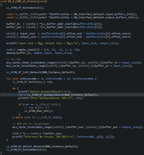

I am currently using the STM32N657-DK board with X-CUBE-AI (ST Edge AI Core v2.2.0).
I have successfully converted a TensorFlow Lite model to run on the NPU and can build and flash the firmware without issues.
Problem
When I call the function
ret = LL_ATON_RT_RunEpochBlock(&NN_Instance_Default);
it never returns.
The variable ret never reaches LL_ATON_RT_DONE, and it seems that the NPU interrupt (NPU3_IRQn) is not triggered.

Is any additional RISAF or RIF configuration required to allow the NPU to generate interrupts in a NonSecure environment?
To enable Epoch Controller interrupts, do I need to explicitly configure ATON_INTCTRL registers (e.g. ATON_INTCTRL_CTRL_SET_EN, ATON_INTCTRL_INTORMSK0_SET), or should X-CUBE-AI handle this automatically?
Could this issue be related to the memory attributes of the NPU region (cacheable vs. non-cacheable)? If so, what configuration is recommended?
Are there any known issues with NPU interrupt routing (NPU3_IRQn) in Secure/NonSecure TrustZone projects on STM32N6?
Thank you very much for your support.

Greetings @seokjs,
I ran into a similar problem, I was triggering my inference with a interruption, but other interruptions, with higher priority, were being called at the same time my inference was running, cutting the process in half, I see you have already checked the NPU NVIC Priority level and trigger, but if your project has a similar behavior to the one I described, I would suggest checking your NVIC Priorities, by properly setting them up in my project I have been able to execute an inference without any major issues.
The model you used was originated from the Model Zoo or did you convert it yourself to a .tflite and then used the X-CUBE-AI package to convert it into a network.c file? Maybe by using a custom model you could have ran into a generation error in the network.c, this is probably a stretch but maybe you could look into the layers in the network.c file and see if you have a final output layer, same goes for network.h which usually has a named last layer.
