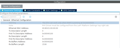

I'm using stm32h747i-DISCO board, and running object detection demo from model-zoo. Now i want to add Ethernet functionality with the demo. I have some questions for the same, as below...
Q1) there is only one linker script in object detection project : STM32H747XIHx_CM7.ld. It's for RAM or FLASH ? how it's running with one .ld file ?
Q2) I have enabled the Ethernet in individual project, in which CUBEmx showing the warning.
In linker script "RAM_D1" is there at 0x24000000.
In object detection project, At 0x24000000 address "AXIRAM" is there...and some Image_Buffers are stored in the same.
Then, how can i make space for Ethernet (LwIP + mqtt)?
which memory should be choose for the same ?
Please guide us for the same, And please share any guide for memory utilisation for AI (model-zoo), how to decide which buffer should be placed in which memory.
