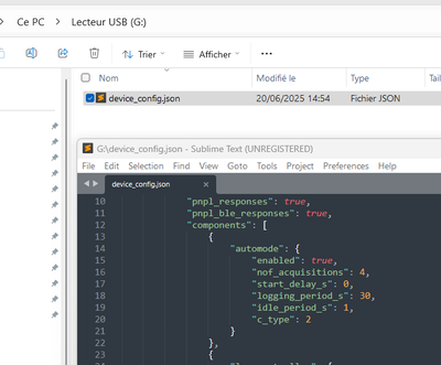

  2. Configured the device_config.json file as shown below and copied it to the root directory of the SD card (which appears as “G:” in my system). Based on the config, I expected to get 4 folders with logs (one per acquisition), each containing 30 seconds of data logging, though I’m not totally sure this is the correct behavior to expect?

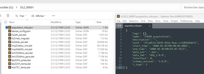

When opening the SD card (G:), I only see one folder, DL2_00001, which contains non-empty .dat files.
In G:/DL2_00001/acquisition_info.json, the start_time and end_time show a duration of about 3 minutes, as expected (see below).

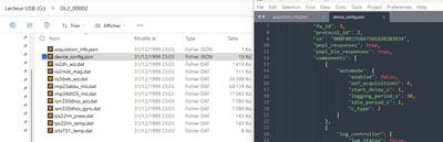

There’s also a new config file at G:/DL2_00001/device_config.json (see below), and interestingly, it shows "enabled": false instead of true, "start_delay_s" turns to 1 instead of 0, but all other parameters (nof_acquisition, ..) are the same than G:/device_config.json. That’s why I suspect the logger is reading the config file located at the root (G:/device_config.json), but for some reasons not using the automode as expected.

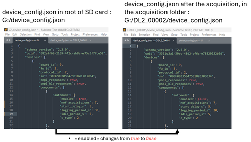

I used the exact same parameters for automode as in the Quick Start Guide (see picture below), and repeated steps 1 to 5. For step 6, I waited 5 minutes, which is more than enough (i.e., 7 * 30 = 210 s = 3.5 minutes).
I noticed that a new device_config.json file appears in the acquisition folder: G:/DL2_00002/device_config.json. In that file, "enabled" is set to false, even though it was set to true in the original config at G:/device_config.json.
So it seems the logger does read the config file from the root directory, but for some reason, it modifies certain automode parameters internally, like "enabled" or "start_delay_s". I have no idea why this happens.

"start_delay_s" = 0 isn’t a valid value, thus invalidating the automode setup. Furthermore, also pressing the USR button will invalidate the automode. The idea beyond automode is to demand the logging session to the json entirely; so, by pressing the USR button you’re overriding the automatic behavior.
