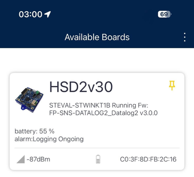

I monitored the logger as much as possible. After 8 hours, the green LED was still blinking, and the ST BLE Sensor app showed:
Alarm: Logging ongoing
Battery: 55%
(see screenshot below)

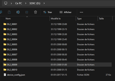

However, when I checked the SD card, I only found about 2.5 hours of data, specifically, 10 folders of 15 minutes each. But I expected at least 8 hours of logging.
