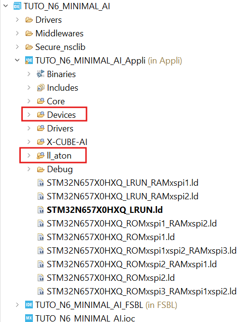

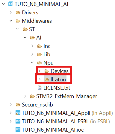

Hello @Z-YF ,
The error "Undefined reference" is due to your linker not being able to correctly retrieve the sources. Both LL and MCU Cache functions are implemented in the AI Middleware package whose NPU folder you can find externally to the FSBL CubeIDE project, as shown in the image below.
To fix this problem, you can add these folders inside the FSBL project. Don't import the whole Middleware folder. Add only the sources (.c) from "Devices" and from "ll_aton" as new folders. You can do these by right clicking on FSBL and selecting "Import". Then under "General" you go on to "File System". Then you should import both the directories shown in image above. Make sure to filter file types on "Filter Types" in order to only import the sources.
Don't forget to set these newly imported folders as source paths. To do so, right click and go on "Properties". On "Properties", go on "C/C++ General" and then "Paths and Symbols". Under "Source Location", add both the "ll_aton" and the "Devices" folders. You should now note this blue "c" icon on top of the folder, as it is already in the previous image.
I've done it for Appli because mine is a LRUN project. Just do yours in FSBL. This should fix your errors.
